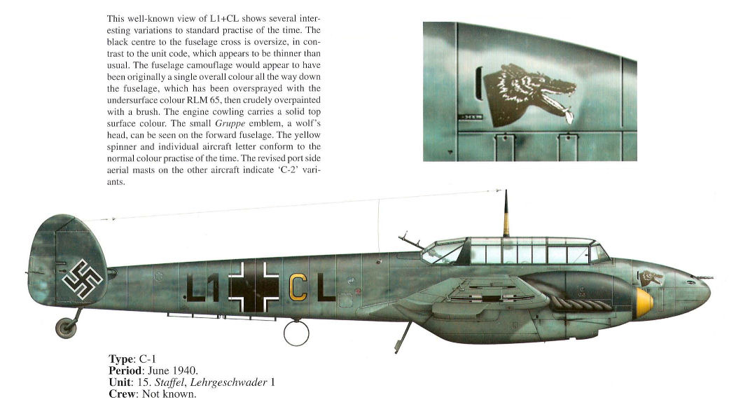

I have a set of Decals I want to use with the Eduard Me 110 C Kit. The Manufacturer states that it is a Me 110 C-1 from I. (SJ) LG 1 with the lettering 4M+DB (D in white) and a big wolve's head on both cowling sides. Unfortunately, no colours or timeframe are mentioned; has anybody an idea, when and where this machine flew, or even has a picture/painting of it? Thanks for your help!

Unit is LG1, there's a wolf head, but coded I1+DY.

Time period would most likely have been 1940-41.
Colours would have been RLM 70 black Green/RLM 71 Dark Green Uppersurface splinter camo with RLM 65 Light Blue lower surfaces.
Hope this helps...

Make me think I've probably done a mistake with the first I've posted, Code may be L1+DY instead of I1+DY ... no ?
