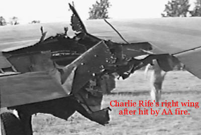

What do you think is stronger, 3/4-2 inches of birch plywood or two thin sheets of dural stretched over dural framing approximately 1/32" thick?
The wood will experience much bigger holes from AP or ball ammo and likewise will suffer greater damage from explosive 2cm and 3cm shells.
Lunatic, where do you get 1/32" (.03125) thick sheets? The P-47's control surfaces utilized 24-ST that was thicker than that. At present, I can only find the thickness of the skin on the dive recovery flaps which was 24-ST that was .188 thick. (No, that is not a typo.)
P-47 hit by an 88mm round.
Marine Major Norman O'Bryan looks through the four-foot hole torn in the wing of his Corsair by flak on his 99th mission.
