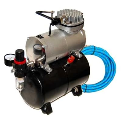

    This is what I'm using with my Iwata HP-CS airbrush, a Smart Jet Pro. Got it for 50 of the Queens best folding in 2008, new!Cost £200+ I see on ebay!
