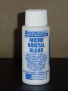

    Next I moved onto the landing lights. If I had thought of it a head of time I would have built these in the extended position but I didn't so I'm just going to drill them out and use some Micro Krystal Klear to make some lenses.
    Before
    After
    I won't be making the lenses until after the paint is applied. This stuff doesn't mask very well.
