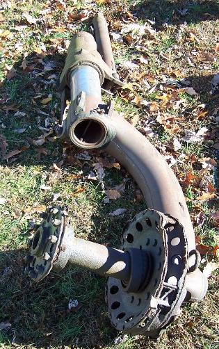

The 32P2004 6 number may be from a B-24. The Stamp with an "H" usually meant the part was heat treated. here's a few sites that might help.
Aviation Archaeology - Aircraft Inspection Stamps
Aviation Archaeology Research Projects
Aviation Archaeology- Part Number Prefix By Aircraft Type
Looking at that landing gear part, I would guess it's from a B-24.
Hope this all helps....

Excellent detection work Joe the hub perforations are Identical

Thank you Flyboyj! There are only some little differences: your leg seems to be a later version ("J"?), my leg its like an "H"
Mick

My Pleasure - and yes, the photo I presented was a B-24J and there could of been minor changes between the "H" and "J."
