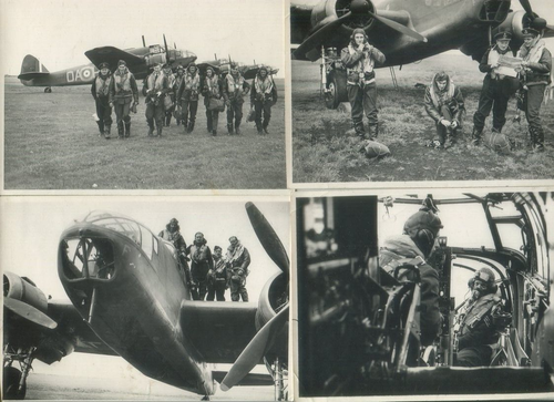

I have just scanned some of a friends Beaufort photos - factory and operational. At least one has been posted before and several have watermarks indicating the original sources. A couple are duplicates but came from different size originals.
Instead of posting 36 individual photos I have created a PDF of them.
